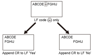

[Append CR to LF]
[Yes], [No]
Enables you to specify whether to append a carriage return (CR) when line feed code (LF) is received.
