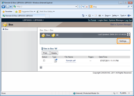

Select the [Box] menu.
3
Enter the box number of the box where the job that you want to check or operate is stored, and then click [Open...].
You can also display the job list inside the box by clicking on the icon displayed on the Box Number.
If a password is specified for the box, enter the password, and then click [OK].
4
Click [Settings...].

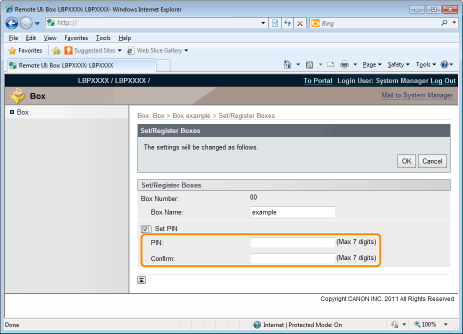

5
Enter the box name in [Box Name].
Up to 32 characters can be entered.
6
Specify the password.
When specifying a password for a box
(1)
Select the [Set PIN] check box.
(2)
Enter the password that you want to specify in [PIN], and then enter the same number in [Confirm] as the one you entered in [PIN].
When not specifying a password for a box
Clear the [Set PIN] check box.
In [PIN] and [Confirm], you can enter the number of 1 to 7 digits except for "0."
7
Click [OK].
