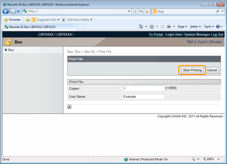

You can display the page that allows you to change the print copies etc. by clicking [Print...].
(3)
Change the settings, and then click [Start Printing].
Changing the number of the print copies
You cannot change the number of the print copies depending on the job.
Also, changes to print runs of saved jobs that have [Prioritize Print Ticket] set in XPS format will be ignored.

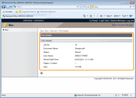

Click the document name to display details of the saved job.
6
The detailed information of the stored jobs is displayed.
