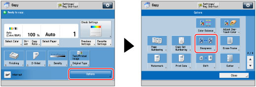

1.
Press
(Main Menu) → [Copy].
2.
Press [Options] → [Sharpness].
3.
Press [Low] or [High] to adjust the sharpness for the Text and Photo/Image areas.
To copy text or lines clearly, the setting should be towards [High] for the Text area. To copy originals containing printed photographs or other halftones, the setting should be towards [Low] for the Photo/Image area.
4.
Press [OK] → [Close].
