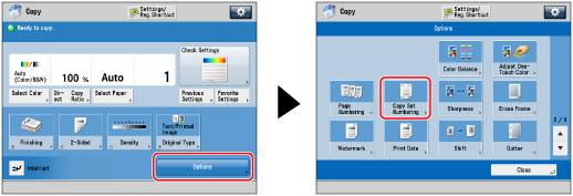

1.
Press (Main Menu) → [Copy].
2.
Press [Options] → [Copy Set Numbering].
