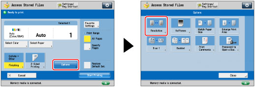

1.
Press (Main Menu) → [Access Stored Files] → [Memory Media].
2.
Select the desired Memory Media → select the directory where the file you want to print is stored.
3.
Select the desired file → press [Print].
4.
Press [Options] → [Resolution].
To change the paper source, see "Paper Selection."
5.
Select the desired resolution → press [OK] → [Close].
[Fine (600 dpi)]:
Files are printed at 600 dpi resolution. This mode is optimal for normal files and tables.
[Superfine (1200 dpi)]:
Files are printed at 1200 dpi resolution. This enables you to reproduce the contours of text and graphics in fine detail. This mode is optimal for printing data including fine and/or faint lines.
