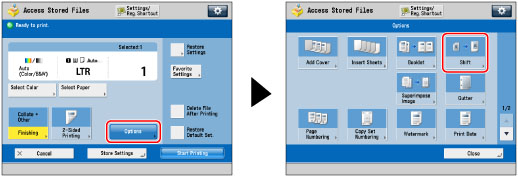

Press [Change Print Settings].
4.
Press [Options] → [Shift].
