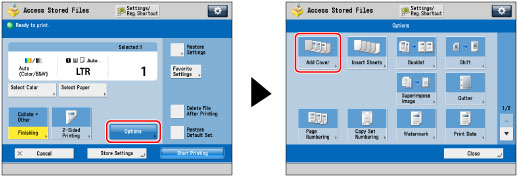

1.
Press (Main Menu) → [Access Stored Files] → [Mail Box].
2.
Select the desired Mail Box → select the desired file → press [Print].
3.
Press [Change Print Settings].
4.
Press [Options] → [Add Cover].
5.
Select the type of cover and printing.
To select the paper for the front and back cover, press [Change] for <Select Paper> → select the paper → press [OK].
