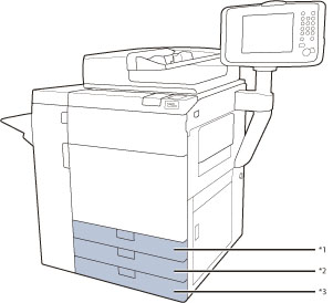

This section describes how to clear a paper jam which occurs in the paper drawers of the machine. The location of the paper drawers of the machine is indicated in the following illustration.
The following illustration indicates the location of the paper jam. Please refer to it to remove the jammed paper.
*1 C-Paper Drawer 1
*2 C-Paper Drawer 2
*3 C-Paper Drawer 3
