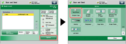

1.
Press (Main Menu) → [Scan and Send].
2.
Specify the destination → press [Options] → [Original Type].
3.
Select the original type.
To adjust the text/photo/map processing priority level, press [Text/Photo].
Then press [Adjust Level] → select [Text Priority] or [Photo Priority] → press [OK].
[Text Priority]:
Priority is given to the faithful reproduction of text.
[Photo Priority]:
Priority is given to the faithful reproduction of photos, with as little moiré effect (a shimmering, wavy pattern) as possible.
You can adjust the text/photo priority level. If you want to reproduce text as faithfully as possible, press [Text Priority], and move the indicator to the left. If you want to reproduce photos as faithfully as possible, press [Photo Priority] and move the indicator to the right.
4.
Press [OK] → [Close].
