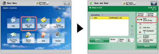

(Main Menu) → [Scan and Send] → specify the destination → press the Select Color button.

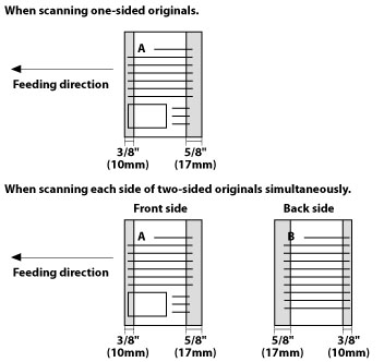

If the color sections are located only in the range indicated by the diagram below, when loading the originals in the feeder
