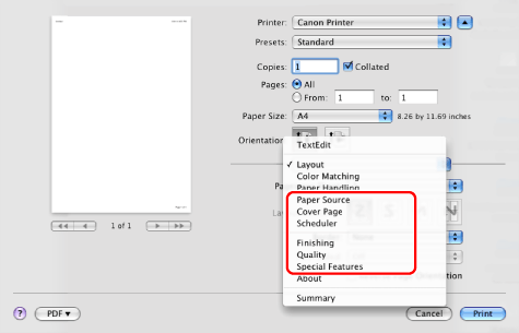

Select your printer from [Printer] → set the number of copies, which pages to print, etc.
If you are using Mac OS X 10.7 or later, clicking [Show Details]/[Hide Details] at the bottom of the screen enables you to display or hide options.
If you are using Mac OS X 10.5 or 10.6, clicking [] to the right of [Printer] enables you to display or hide options.
If the paper size you require is not displayed in [Paper Size], you can register a new paper size (see "Setting Custom Paper Sizes").
If the above functions cannot be set in the upper part of the [Print] dialog box, display and set them in the [Copies & Pages] preferences pane or the [Page Setup] dialog box.
3.
Select the appropriate preferences panes → set any required functions.
The default setting for [Print Style] in the [Finishing] preferences pane is [2-sided printing]. For details, see "1-sided and 2-sided Printing."
For information on available printing functions, see "Printing Functions" or Help (see "Viewing Help").
