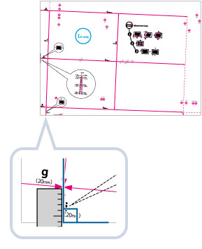

Measure the length of the 'i' and 'j' marks on the test page.
The mark 'i' is printed on the left side lead edge and the mark 'j' is printed on the left side tail end of the feeding direction.
Example: 'i' = 21.0 mm, and 'j' = 20.5 mm
Measure the length of the 'i' and 'j' marks correctly as shown below.
                              Correct
Incorrect
Return to the <Correct Image Misalignment> screen → enter the measured length of [i] and [j] for front and back sides.
Using the following two numerical values and "h = 360.0", a device adjusts so that the printing area and the paper may become parallel.
[i]:
Enter the measured length of 'i' mark on the test page.
[j]:
Enter the measured length of 'j' mark on the test page.
Following the example, enter 21.0 for 'i' and 20.5 for 'j'.
The difference between 'i' and 'j' (0.5 mm) is corrected.
