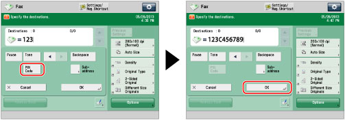

2.
Enter the fax number (Press [PIN Code] in the position you want to insert the PIN Code) → press [OK].
<C> is displayed on the screen after you press [PIN Code].
If [Prefix] or [Suffix] is set for [PIN Code Position] in [PIN Code Access], it is not necessary to press [PIN Code].
(See "PIN Code Access.")
[PIN Code] can be pressed either before the fax number, after the fax number, or while specifying the fax number.
