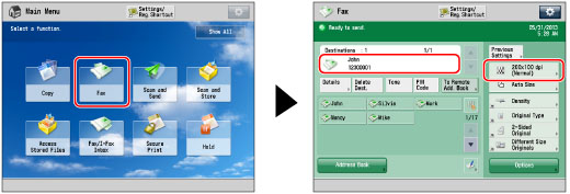

You can adjust the resolution to use for sending faxes. The higher the resolution, the clearer your faxes will be.
1.
Press (Main Menu) → [Fax] → specify the desired destinations → press the resolution button.
2.
Select the resolution → press [OK].
