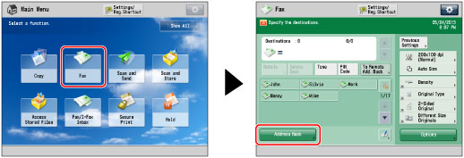

1.
Press
(Main Menu) → [Fax] → [Address Book].
