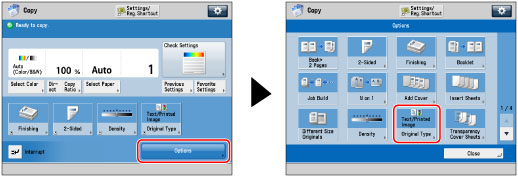

1.
Press (Main Menu) → [Copy].
2.
Press [Options] → [Original Type].
