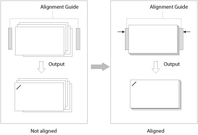

The copied or printed paper may shrink because of temperature, humidity, or a characteristic of the paper type. In this case, this mode enables you to align copied or printed papers by adjusting the position of the alignment guide inside the finisher so as to staple the aligned papers.

Press [-] or [+] to adjust the alignment guide's position → press [OK].
Press [+] to set the alignment guide’s position closer to the paper.
You can switch between positive and negative values by pressing [±].
If the alignment guide's position is too close to the paper, a paper jam or paper crease may occur. Make sure to perform fine adjustment of the alignment guide's position.
