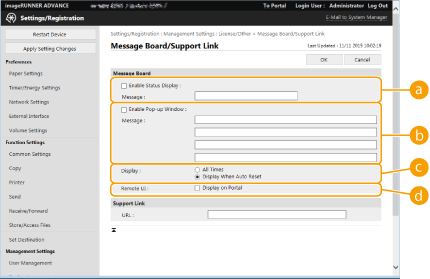

      Click [License/Other]  [Message Board/Support Link].
      4
      Enter the message, and click [OK].
      [Enable Status Display]
      To display the message at the bottom of the touch panel display, select the check box and enter the message in [Message]. Use this setting for displaying operational tips and other low-priority messages.
      [Enable Pop-up Window]
      To display the message in a pop-up window on the touch panel display, select the check box and enter the message in [Message]. Use this setting for displaying high-priority messages.
      [Display]
      Select the display method for the pop-up window.
      [All Times]
      The pop-up window is displayed continuously, and the machine cannot be operated. Use this setting for messages such as an out-of-service notice.
      [Display When Auto Reset]
      The pop-up window is displayed when no operations are performed for a specified period of time, or when the machine is restarted. Use this setting for messages such as a maintenance schedule notice.
      [Remote UI]
      If you select the check box, the message shown in the pop-up window is also displayed on the Remote UI portal page.
