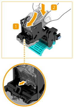

      Insert the new staple cartridge in the staple case.
      Diagonally insert the tab on the front of the staple cartridge into the hole in the staple case, as shown in the illustration.
      Push down on the back of the staple cartridge until it clicks into place.
      IMPORTANT:
      Make sure to insert the front part of the staple cartridge first. Do not attempt to insert the back side of the staple cartridge first, as shown in the illustration below.
