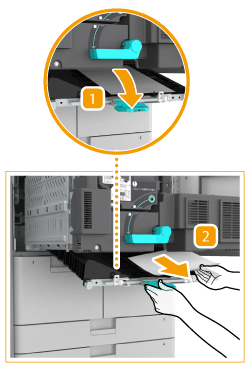

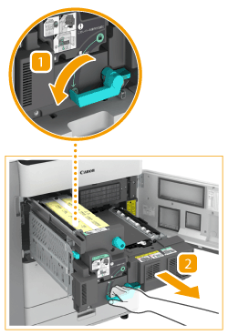

      Pull out the fixing transport unit.
      Turn the green lever to the left.

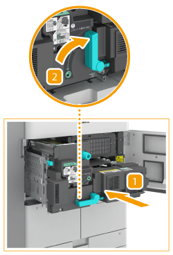

      Push the fixing transport unit back into its original position, and close the front cover.
      Push the fixing transport unit back into its original position.
      Return the green lever to its original position.
