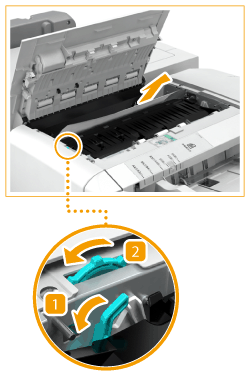

      4
      Lift the release lever, and remove the jammed document while rotating the dial.
      Lift the release lever.
      Turn the dial counterclockwise, and remove the jammed document.
      The jammed document moves to the document output tray.
      Lower the release lever.
