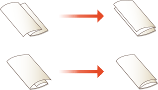

      You can adjust the folding positions of the paper, such as when performing Z-fold or C-fold using the optional paper folding unit.
      1
      Press   <Adjustment/Maintenance>  <Adjust Action>  <Adjust Fold Position>.
      2
      Select the folding type you want to adjust.
      When you select <Adjust Saddle Fold Position>, also select the paper size.
      3
      Adjust the folding position.
      4
      Press <OK>.
      When <Adjust Saddle Fold Position> is selected, press <OK>  <Close>.
