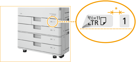

Change the paper size label of the paper drawer as necessary.
Attach the paper size label at the same height as the cassette number indicator, and approximately 1/4" (5 mm) to the left.
* Approximately 1/4" (5 mm)
