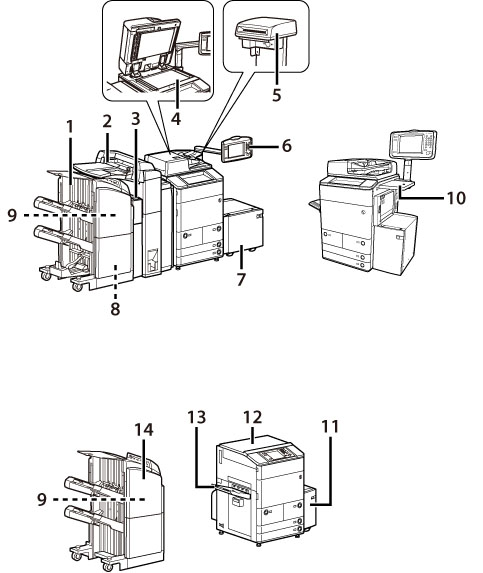

Optional Equipment
1.
Booklet Finisher-L1
The Booklet Finisher-L1 is equipped with the following features: Collate, Group, Offset, Staple (Corner, Double, and Saddle Stitch), and Saddle Fold.
2.
Document Insertion/Folding Unit-G1/Document Insertion Unit-J1
If the Document Insertion/Folding Unit-G1 or Document Insertion Unit-J1 is attached to a finisher, a different type of paper from the body of the document can be inserted for a cover or insert. If the Document Insertion/Folding Unit-G1 is attached, the paper can be folded in 2 different ways (Z-Fold, C-Fold).
3.
External 2/3 Hole Puncher-A1
The External 2/3 Hole Puncher-A1 is equipped with the Hole Punch mode. The External 2/3 Hole Puncher-A1 can be attached only if the Staple Finisher-L1 or Booklet Finisher-L1 is attached.
4.
Duplex Color Image Reader Unit-F1
Originals placed in the feeder are automatically fed sheet by sheet to the platen glass for scanning. You can scan documents such as books, thick originals, thin originals, and transparencies on the platen glass of the Duplex Color Image Reader Unit-F1.
5.
Copy Card Reader-F1
The Copy Card Reader-F1 enables Department ID Management to be performed through the use of cards.
6.
Upright Control Panel-B1
The large size touch panel display enables you to operate the machine more efficiently. You can also adjust the position and angle of the control panel to enable you to see the touch panel display more clearly.
7.
POD Deck Lite-A1
If the POD Deck Lite-A1 is attached, it can provide an additional paper source. The POD Deck Lite-A1 holds up to 3,500 sheets of paper (20 lb bond (80 g/m2)).
8.
Staple Cartridge-D2/Staple Cartridge-D3
The Staple Cartridge-D2/Staple Cartridge-D3 can be attached to the Booklet Finisher-L1 for saddle stitching.
9.
Staple-J1
Staple-J1 can be attached to the finisher for stapling (Corner and Double).
10.
Utility Tray-A2
The Utility Tray-A2 provides space to place originals.
11.
Paper Deck Unit-C1
If the Paper Deck Unit-C1 is attached, it can provide an additional paper source. The Paper Deck Unit-C1 holds up to 3,500 sheets of paper (20 lb bond (80 g/m2)).
12.
Printer Cover-B1
Instead of the Duplex Color Image Reader Unit-F1, you can attach the Printer Cover-B1.
13.
Copy Tray-P1
The Copy Tray-P1 is equipped with the following features: Collate, Group, and Rotate 90 Degrees.
14.
Staple Finisher-L1
The Staple Finisher-L1 is equipped with the following features: Collate, Group, Offset, and Staple (Corner and Double).
