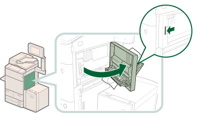

3.
Open the right cover of the main unit.
4.
Remove any jammed paper.
1. Remove any jammed paper from the outside of the upper right cover.
2. Remove any jammed paper from the inside of the upper right cover.
5.
Close the right cover of the main unit.
