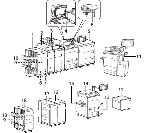

1.
Booklet Finisher-K1
The Booklet Finisher-K1 is equipped with the following features: Collate, Group, Offset, Staple (Corner, Double, and Saddle Stitch), and Saddle Fold.
2.
Paper Folding Unit-G1
If the Paper Folding Unit-G1 is attached to the Staple Finisher-K1 or Booklet Finisher-K1, the paper can be folded in 5 different ways (Z-Fold, Half Fold, C-Fold, Accordion Z-Fold, Double Parallel Fold).
3.
Document Insertion Unit-H1
If the Document Insertion Unit-H1 is attached, a different type of paper from the body of the document can be inserted for a cover or insert.
4.
Duplex Color Image Reader Unit-F1
Originals placed in the feeder are automatically fed sheet by sheet to the platen glass for scanning. You can scan documents such as books, thick originals, thin originals, and transparencies on the platen glass of the Duplex Color Image Reader Unit-F1.
5.
Multi-drawer Paper Deck-A1
If the Multi-drawer Paper Deck-A1 is attached, it can provide three additional paper sources. Up to 2,000 sheets of paper (20 lb bond (80 g/m2)) or 2,200 sheets of paper (17 lb bond (64 g/m2)) each can be loaded into the upper, middle, and lower decks of the Multi-drawer Paper Deck-A1.
6.
Copy Card Reader-F1
The Copy Card Reader-F1 enables Department ID Management to be performed through the use of cards.
7.
Staple-P1
The Staple-P1 can be attached to the Booklet Finisher-K1 for saddle stitching.
8.
Inner Booklet Trimmer-A1
The Inner Booklet Trimmer-A1 is equipped with the Trim mode. The Inner Booklet Trimmer-A1 can be attached only if the Booklet Finisher-K1 is attached.
9.
Staple-N1
Staple-N1 can be attached to the finisher for stapling (Corner and Double).
10.
Puncher Unit-BF1
The Puncher Unit-BF1 is equipped with the Hole Punch mode. The Puncher Unit-BF1 can be attached only if the Staple Finisher-K1 or Booklet Finisher-K1 is attached.
11.
Utility Tray-A2
The Utility Tray-A2 provides space to place originals.
12.
POD Deck Lite-A1
If the POD Deck Lite-A1 is attached, it can provide an additional paper source. The POD Deck Lite-A1 holds up to 3,500 sheets of paper (20 lb bond (80 g/m2)).
13.
Paper Deck Unit-C1
If the Paper Deck Unit-C1 is attached, it can provide an additional paper source. The Paper Deck Unit-C1 holds up to 3,500 sheets of paper (20 lb bond (80 g/m2)).
14.
Printer Cover-B1
Instead of the Duplex Color Image Reader Unit-F1, you can attach the Printer Cover-B1.
15.
Copy Tray-P1
The Copy Tray-P1 is equipped with the following features: Collate, Group, and Rotate 90 Degrees.
16.
Professional Puncher-C1
The Professional Puncher-C1 punches several types of hole. For more information on the Professional Puncher-C1, see the instruction manual of the Professional Puncher-C1.
17.
Professional Puncher Integration Unit-B1
The Professional Puncher Integration Unit-B1 reverses the paper punched by the Professional Puncher-C1 to prevent a paper jam.
18.
Staple Finisher-K1
The Staple Finisher-K1 is equipped with the following features: Collate, Group, Offset, and Staple (Corner and Double).
