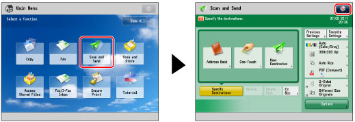

1.
Press [Scan and Send] → .
2.
Press [Register Options Shortcuts].
3.
Select the button to register to.
4.
Select the [Options] mode you want to assign as a shortcut → press [OK].
If you do not want to assign an option, select [Unassigned].
5.
Press [OK].
6.
Press [Close].
