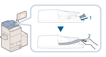

1.
Adjust the slide guides to fit the size of your originals.
2.
Neatly place your originals with the side to be copied face up into the original supply tray.
Place your originals as far into the feeder as they will go, until the Original Set Indicator is lit.

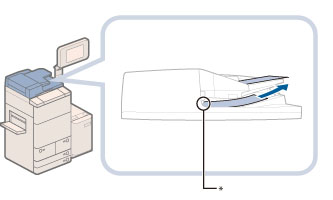

When scanning is complete, remove the originals from the original output area to avoid paper jams. (When you use the Duplex Color Image Reader Unit-F1, the Original Output Indicator blinks for a certain time when scanning is complete.)
* Original Output Area
Do not place items in the original output area, as doing so may cause damage to your originals.
