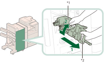

Pull out the saddle stitcher unit.
*1 Stapler Unit of the Saddle Stitcher Unit
*2 Saddle Stitcher Unit
1. Grip the handle of the saddle stitcher unit, and pull out until it stops.
2. Pull the stapler unit of the saddle stitcher unit towards you, and then push it up.

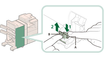

Push up the tab on the staple case.
1. Push down Part A to unlock.
2. Push up Part B.
5.
Remove any jammed staples.
1. Remove any jammed staples.
2. Return Part B to its original position.
