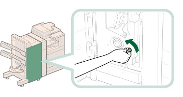

Turn the knob on the right in the direction of the arrow (counterclockwise) until it stops.

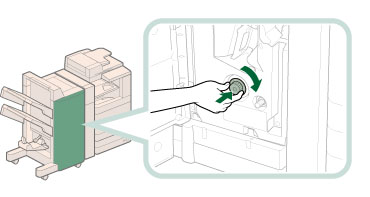

While pushing in the knob on the left, turn it in the direction of the arrow (clockwise).

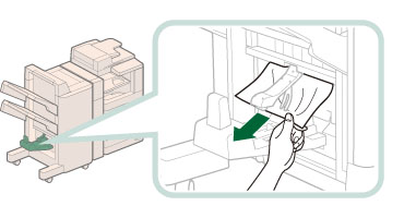

Remove any jammed paper protruding from the output part.

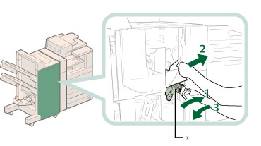

Remove any jammed paper from the lower delivery guide.
* Lower Delivery Guide
1. Turn the lever on the lower delivery guide to the right until it stops, and then tilt the lower delivery guide to the right.
2. Remove any jammed paper.
3. Return the delivery guide to its original position.
CAUTION
When returning the lower delivery guide to its original position, be careful not to get your fingers caught, as this may result in personal injury.
