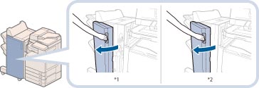

The Staple Finisher-M1 and Booklet Finisher-M1 are optional products.
We recommend that you order staple cartridges from your local authorized Canon dealer before your stock runs out.
Use only staple cartridges intended for use with this machine.
IMPORTANT
Do not remove the seal that holds the staples together before you place the staple cartridge into the staple case.
Only one staple cartridge can be inserted at a time.
Make sure that you pull the seal straight out. If you pull it out at an angle, it may tear.
CAUTION |
When closing the front cover of the finisher, be careful not to get your fingers caught, as this may result in personal injury.
After the cover is closed, the stapler unit may automatically perform a "dry" stapling operation to reposition the staples.
