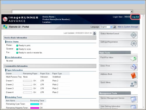

When you are finished with the operation, press [Log Out] or
(Log In/Out) on the control panel to log out. |
