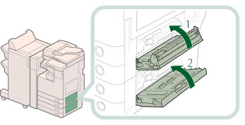

1.
Open the paper drawer's upper right cover and lower right cover.
1. Open the paper drawer's upper right cover.
2. Open the paper drawer's lower right cover.

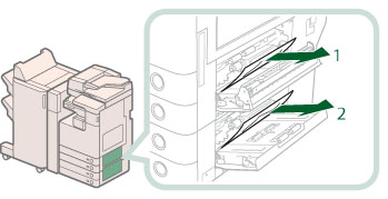

2.
Remove any paper jammed in the paper drawer's upper right cover and lower right cover.
1. Remove any paper jammed in the paper drawer's upper right cover.
2. Remove any paper jammed in the paper drawer's lower right cover.

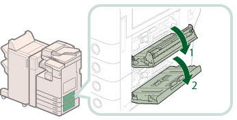

3.
Close the covers.
1. Close the paper drawer's upper right cover.
2. Close the paper drawer's lower right cover.
CAUTION
When closing the covers, be careful not to get your fingers caught, as this may result in personal injury.
Gently close the covers until they click into place in the closed position.

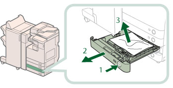

4.
Remove any paper jammed in the cassette feeding unit.
1. Press the open button of the paper drawer that is feeding the paper.
2. Grip the handle, and pull out the paper drawer until it stops.
3. Remove any jammed paper.
