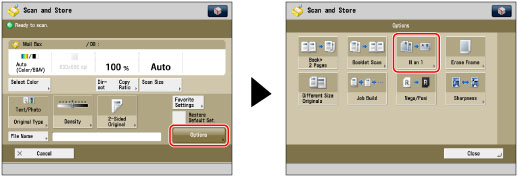

1.
Press [Scan and Store] → [Mail Box].
2.
Select the desired Mail Box → press [Scan].
3.
Press [Options] → [N on 1].
4.
Select the type of N on 1.
If you place a two-sided original, press [2-Sided Original] → select the type of two-sided original → press [OK].
