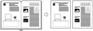

This mode enables you to scan facing pages of a book or bound original, and then print or store them as two separate pages.

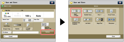

1.
Press [Scan and Store] → [Mail Box].
2.
Select the desired Mail Box → press [Scan].
3.
Press [Options] → [Book2 Pages].
4.
Press [Close].
To scan multiple facing pages, turn the page of the original when scanning is complete → place your original on the platen glass → press (Start).
After the last batch of originals is scanned, press [Start Storing].
