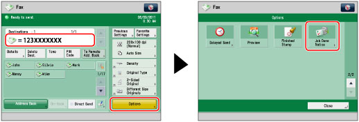

Press [Fax].
2.
Specify the destination → press [Options] → [Job Done Notice].
3.
Select the destination for the job done notice → press [OK].
For instructions on searching for destinations registered in the Address Book, see "Address Book Screen."
4.
Press [Close].
