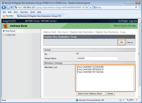

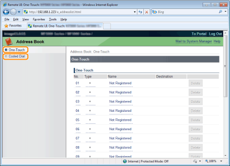

(1)
Click [No.], [Type] or [Name].
(2)
Click [Edit].
(3)
Click [Select from Address Book].
(4)
Click [One-Touch] or [Coded Dial] from the drop-down list and click [Display].
(5)
Select the check box of the destination which you want to add to the group and click [OK].
(6)
Make sure the destination you registered is displayed in [Members List] and click [OK].

(1)
Select [One-Touch] or [Coded Dial] from the drop-down list and click [Display].
(2)
Select the check box of the destination which you want to register in the group.
(3)
Click [OK].
