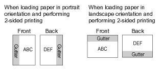

[Binding Location]
[Long Edge], [Short Edge]
Specifies which edge of the paper, the long edge or short edge, is to be bound. When performing 2-sided printing, the printer adjusts the binding location automatically according to the paper surface.
If [Long Edge] is specified, the binding location is created on the long edge of the paper.

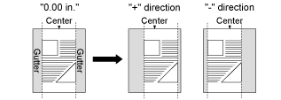

[Gutter]
-1.97 to 0.00 to +1.97 (in.)
Specifies the gutter width for printing with the binding location created. A gutter is created with the image shifted by the specified value.
You can shift the image in the "+" direction with a positive value and in the "-" direction with a negative value.
