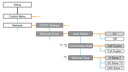

*1
[Communication Mode] and [Ethernet Type] are displayed when [Auto Detect] is set to [Off].
*2
[Communication Mode] appears only when [Ethernet Type] is set to a setting other than [1000 Base-T].

This printer can detect the communication method and Ethernet type automatically. Normally, set [Auto Detect] to [On].
If you want to fix the communication method and Ethernet type, set [Auto Detect] to [Off]. |
If you are using a hub, match the settings for the hub and the printer.
(1)
Select [Auto Detect] using [
] and [ ], and then press [OK]. |
(2)
Select [On] using [
(1)
(2)
Select [Off] using [
(3)
Select [Communication Mode] using [
(4)
Select an Ethernet communication method appropriate for your network environment using [
(5)
Select [Ethernet Type] using [
(6)
Select an Ethernet type appropriate for your network environment using [
