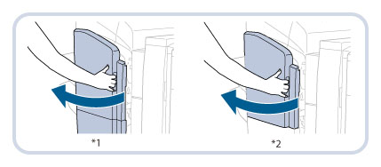

Open the front cover of the finisher.
*1 Booklet Finisher-T1
*2 Staple Finisher-T1
